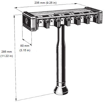

  • MAPS (manual autojoint probe stand)Storage rack for holding up to six autojoint mounted probes and extension bars
  • Mounts directly to CMM table or any other suitable surface
  • Rack height can be set using 100 mm and 200 mm autochange rack legs, to suit longer probe extensions and stylus configurations
  • Can be vertically mounted with a wall mounting bracket
Dimensions
Height
285 mm (11.22 in) without leg extensions
Depth
80 mm (3.15 in)
Width
235 mm (9.25 in)
Additional legs:
Height
100 mm (3.94 in) or 200 mm (7.87 in)
Mounting
Single leg or wall bracket
MAPS dimensioned
Configuration shown is 485 mm (19.10 in) high including 200 mm (7.87 in) leg extension:
